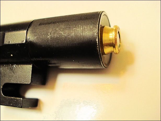

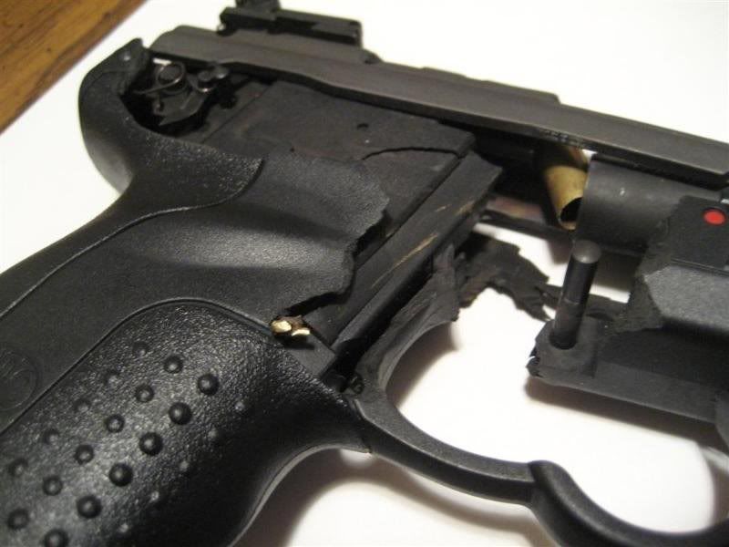

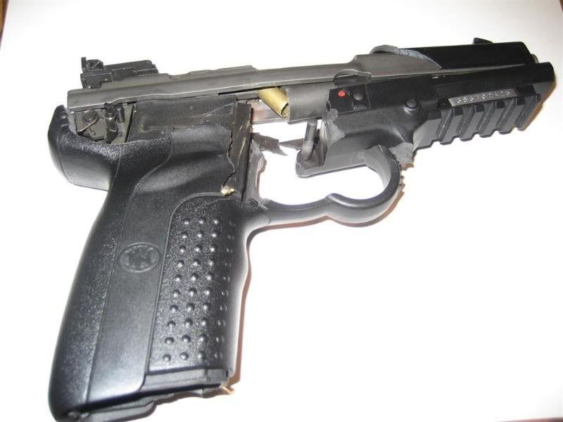

大家可以看见弹壳卡在套筒和枪管末端,并且有貌似弹壳的碎片(在扳机护圈末端左上方)
    A gun exploded in a customer's hands and the manufacturer doesn't seem to care, according to f3rr37 in the FivesevenForums. He wrote, "On the 2nd round I realigned my sights, slowly pulled the trigger, and all hell broke loose. I saw bits and pieces of the top of the slide cover blow. My first reaction was, "Oh crap what just happened." My second reaction was, how are my hands?" F3rr37 sough medical attention and two days later contacted Five-seveN customer support. After a series of followup calls, Five-seveN said they were sending out a pre-paid packing slip for the gun and would inspect it, destroy it, and give f3rr37 a "deep discount" on a new gun. A month later, none of these promises have materialized. F3rr37 thinks the problem with the gun is that it fired "out of battery," and that the problem with Five-seveN is that they just wish he would go away. Which is odd, considering that they are supposed to have a great reputation for being customer friendly. F3rr37 pledges, "Until they make this right, I will never buy another FN product again and will continue to share my experience with what happens when a FiveseveN fires."
    这段E文是讲一个外国佬买了把FN57,然后在他重新瞄准,慢慢地扣动扳机,开始第二轮射击的时候,一切都麻烦都爆发了! 他看见套筒顶部爆裂,碎片飞溅。他的第一反应是:噢!竟然炸膛鸟!第二反应是:我的手还好吧?他马上去医院处理了受伤的手,2天后联系了FN的客户服务部门,在打了N次电话后,FN终于答应会为那FN57提供一个预付了运费的返厂包裹单,方便他把FN57送回去,并且FN承诺会检查,然后销毁那把FN57.并且在他买回一把FN57时给一个很高的折扣。但一个月以后,FN的承诺没有实现。他认为这把FN57会出现这样的问题是因为“out of battery”(没电池?我不知道确切意思是啥,只能这样鸟~)。。。另外这个问题考虑到FN觉得自己有大的声誉,而且又保持良好的客户口碑,只是想他会离开,并且他的FN57只是个别问题,所以FN就不管了。所以那个外国佬说:“我不会再不买他们的产品并且会告诉朋友我的经历,直到FN解决我的问题。

out of battery有点"没有下文" 的意思 瞎猜
是枪的问题而不是弹药的问题?
作者: fn572008    时间: 2008-5-22 04:21
FN估计鉴定了是弹药的问题才会作出这样决定吧……看样子像是子弹的问题……弹壳体的瓶颈型部分已经分解掉了……愚见各位继续……

原帖的论坛上分析了FN是因为说明书里有说明使用自装弹药就会使保修作废的。 这个人是用自己装药和弹头的弹药所以FN不予理会了。因为自己装的弹头超过了设计上限导致抛壳机构无法正常工作导致的事故。这种情况在欧美产品上实际上发生几率不高,但是东欧和亚洲仿品反而频频发生。 很多SVD和北方工业的产品使用自装弹都频繁咳嗽甚至炸膛。
整体上来看步枪发生这样事故多于手枪。无非是用户为了贪图减少成本或者提高性能自行DIY装药和弹头导致的。

out of battery
簡單說是弹藥沒有完全进膛, 但處於可擊發狀態, 一旦擊發, 高壓溢出...后果如上...

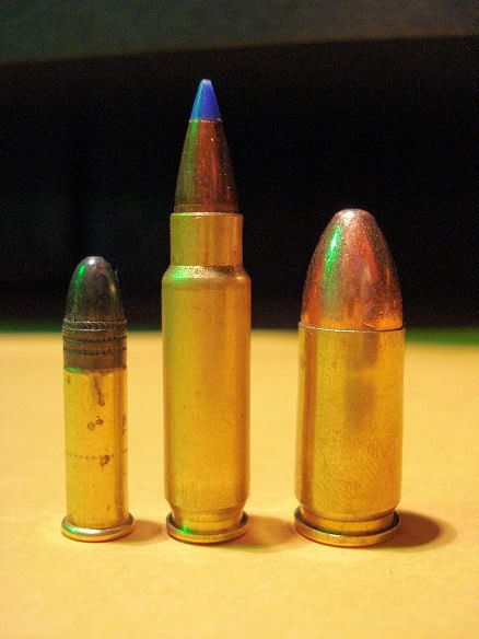

弹药的对比,左边是。22LR 右边是9MM。

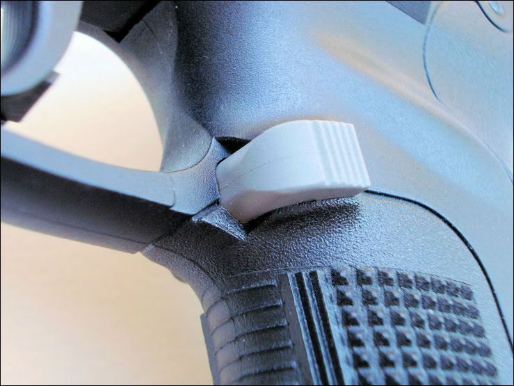

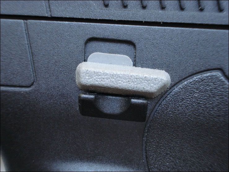

弹匣扣。

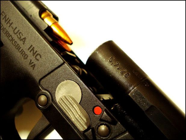

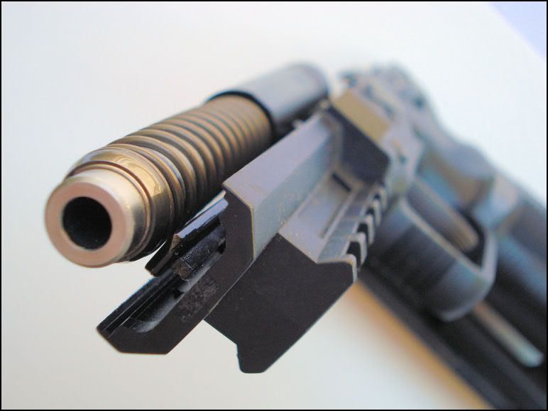

枪管末端细节,注意上面的刻印。

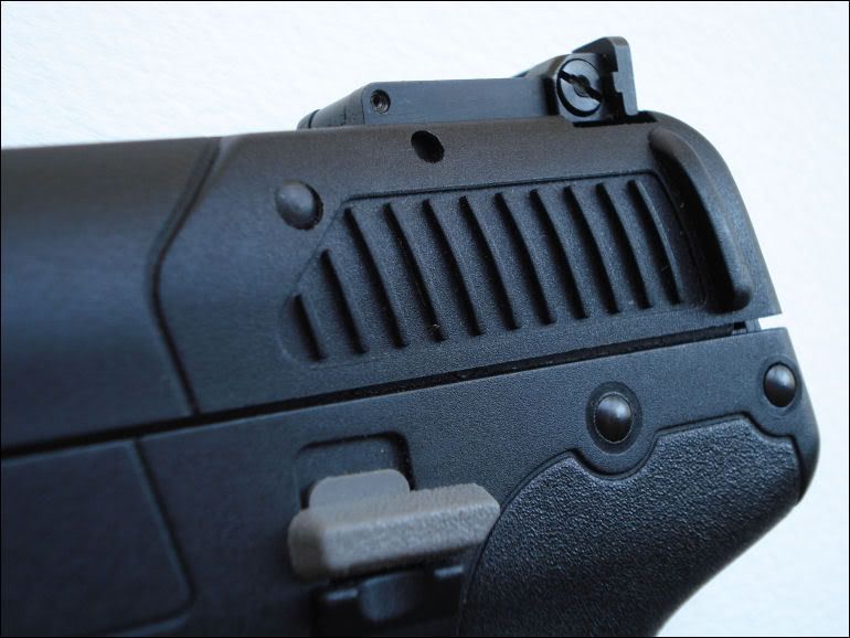

套筒后部,可以看出套筒外部是被工程塑料全包覆的。

另一面枪管末端细节,可以看出FN57的枪管是没有闭锁机构的,它采用的是自由枪机式的自动方式

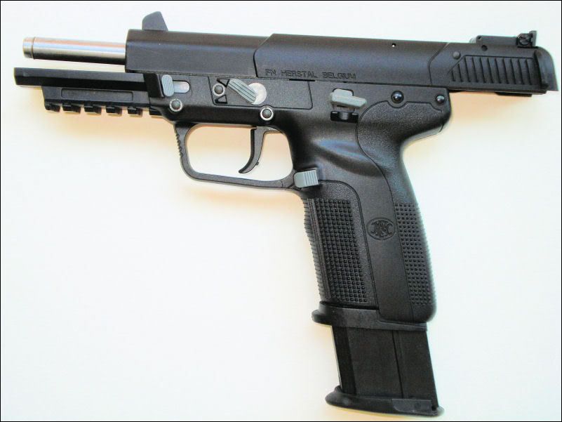

全身图

作者: Kane_Schen    时间: 2008-5-30 09:26
炸膛90都是弹药问题
